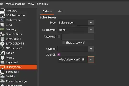

UPDATE:
I disabled Listen Type to None
like thisenter image description here
but I get a very glitchy image:

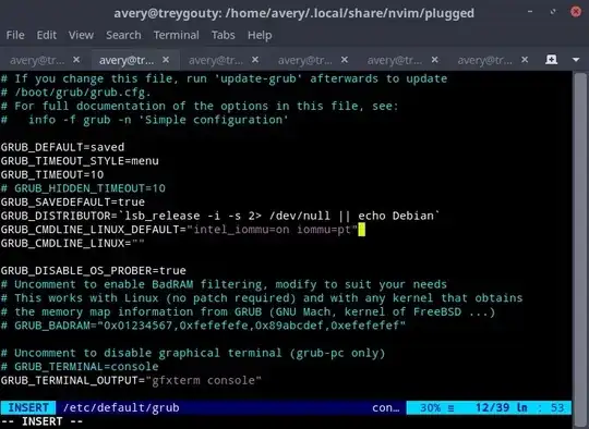

OpenGL + 3D Rendering work great with iommu if you have VT-d support on your motherboard + processor. First look up your hardware to see if it supports VT-d. If it does, do the following:
Edit the file /etc/default/grub as root (use sudo), adding the following to the line beginning GRUB_CMDLINE_LINUX_DEFAULT:
For Intel, intel_iommu=on iommu=pt. for AMD, amd_iommu=on. Eg.:
sudo nano /etc/default/grub
adding iommu boot flags to /etc/default/grub file
After saving and closing, type grep CMDLINE_LINUX_DEFAULT /etc/default/grub in your terminal. If you did everything right, you will see the line you edited with the new code. Eg.:
$ grep CMDLINE_LINUX_DEFAULT /etc/default/grub
GRUB_CMDLINE_LINUX_DEFAULT="intel_iommu=on iommu=pt"
Then, run sudo update-grub to apply the changes and reboot.
(update-grub is a shortcut on Debian-derived distros for the command grub2-mkconfig -o /boot/grub/grub.cfg)

Here's my xml for the devices in question:
Display Spice - note: with passthrough you cannot enable a remote server:
<graphics type="spice">
  <listen type="none"/>
  <image compression="off"/>
  <gl enable="yes"/>
</graphics>

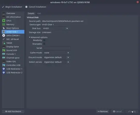

Unrelated, I'm using a zvol block device on Ubuntu's ZFS installer config. It's an option available in the Ubuntu Desktop version only:
ZFS zvol for NTFS block device
zvols are really cool because you can switch between using them for kvm-qemu and [systemd-container][5] (linux only, obviously) - plus snapshot and send / receive them.
But since zvols mimic a regular disk, they demonstrate that you could use a dedicated disk for your VM if you have room to install one, as well.
Once you make the zvol, give it a gpt partition structure using fdisk/sgdisk/{g}parted etc. just like you would any other disk. Once I created the gpt partition, I used the Windows ISO to do the actual partitioning.
btrfs has something similar which should be better supported by systemd-nspawn, but I am not sure if you can operate them like a block device in qemu.
Last tip: I needed to copy some files from the host to the VM. You can't really mount a folder from Linux --> Windows, but I could mount the partition (#3) Windows created on the zvol in the host as a regular NTFS partition.
So while the VM was off, I mounted partition 3 on /mnt, copied the folder I needed, umount /mnt the partition and start the VM back up.
Sometimes it's a little tricky to figure out what to do in that situation, so I thought I'd throw that in. People in guides I've read have also recommended setting up Samba sharing if you need something more frequent, or I also remote to Windows VMs using OpenSSH-Server and PSRemoting, as well, so there's lots of options (Windows even has SSHFS now, if you check out Chocolatey).

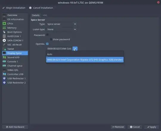

I also faced the same problem while working on software based Hardware Acceleration as specified by: http://ryan.himmelwright.net/post/virtio-3d-vms/ . I tinkered around a little bit and found simple a solution which worked for me. But I cannot guarantee that it will work for you too:
I assume you have changed the 'Model' from 'QXL' to 'Virtio' and enabled '3D Acceleration' in 'Video Device' section along with the settings you specified above. I also assume the renderer that you have selected in the 'OpenGL' dropdown is your Dedicated GPU.
Now, just close your virt-manager instance and restart it from terminal by appending DRI_PRIME=1 before it i.e. run DRI_PRIME=1 virt-manager in terminal. Now start your VM. Initially, I saw some screen glitches, but after the login screen was opened, the things ran smoothly. I monitored my AMD DGPU usage through radeontop and it was running fine.
