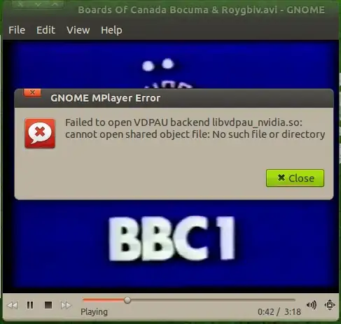

Using GNOME Mplayer everytime I play a video, I get the annoying dialog pop-out in the screenshot below.

I'm using the proprietary NVIDIA driver and I fixed this by creating a symlink to the VDPAU lib:
ln -s /usr/lib/vdpau/libvdpau_nvidia.so.1 /usr/lib/libvdpau_nvidia.so
This has the benefit of actually enabling VDPAU rather than falling back to XV or X11. Of course you need a video card that supports VDPAU acceleration.

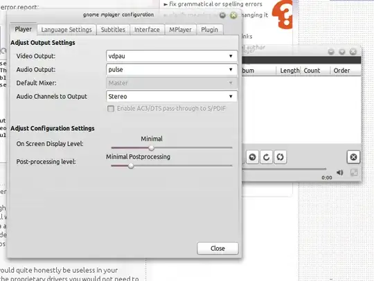

However, a little setting can sort out the problem as follows;
  • Open Edit → Preferences in the GNOME Player menubar
  • Select the "Player" tab
  • Select x11 for the Video Output
  • Close preferences and try to open the video file again.
Your problem should have been resolved.

Don't laugh, (okay, laugh at me, go ahead ;) - but I just opened Gnome-MPlayer for myself and in preferences, you can choose your video output module! All you need to do now is to choose one that works for you (vaapi should work on your graphics card).

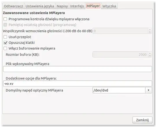

Under the MPlayer tab (not shown), you can also add command line parameters to pass to MPlayer just in case.

add -vo xv
