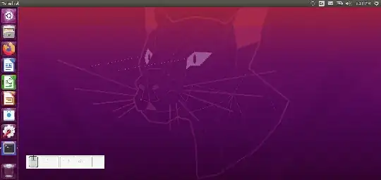

First thing to note is that Ubuntu 16.04 LTS used Unity desktop as desktop environment.
You are probaly talking about HUD.
So on Ubuntu 20.04 LTS you have to install Unity desktop back by
sudo apt-get install ubuntu-unity-desktop
and continue to use it as before:
HUD on Unity
The bad thing there is that Unity is now considered obsolete product.
So better solution is to install MATE desktop by sudo apt-get install ubuntu-mate-desktop^ and then enable HUD in the MATE Tweak and enjoy the HUD by pressing left Alt:
HUD on Ubuntu MATE
Note: you can always remove GNOME Shell using my other answer.
