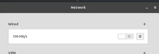

I have a 2Gpbs network connection, and a CAT7 LAN cable connecting my modem to my laptop.
However, Ubuntu shows it only as 100mb/s when I connect the LAN cable. Even my wireless is 300mb/s!
I connected the same LAN cable to a windows machine and it shows close to 1gb/s. So it's definitely not the LAN cable. There's some weird setting that's preventing the proper speed.
Setting up the LAN connection was also a pain, having to set default NetworkManager and what not following a few other answers (No wired connection - Wired unmanaged ubuntu 18.04)
I also tried this solution Cat 6 Only 100mbit speed and ran
sudo ethtool -s enp109s0f1 autoneg off
sudo ethtool -s enp109s0f1 speed 1000 duplex full
but it says
Cannot set new settings: Invalid argument
not setting speed
not setting duplex
I'm at a loss and honestly quite tired of this. Does anyone know whats wrong?

EDIT: Further info:
According to https://serverfault.com/questions/396782/debian-set-eth0-autoneg-off-speed-1000-duplex-full-invalid-argument , you cannot set autoneg off for base speed 1000. I ran
sudo ethtool -s enp109s0f1 speed 1000 duplex full autoneg on and
now it just shows 'cable unplugged' in wired and refuses to use it at all. Ugh.
