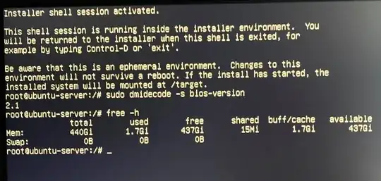

Other info requested in comments below: Output of sudo dmidecode -s bios-version and free -h
Output of commands

From the comments...
Your BIOS is current. AMD processors are funny about RAM. Although it'll take forever on your configuration, go to https://www.memtest86.com/ and download/run their free memtest to test your memory. Get at least one complete pass of all the 4/4 tests to confirm good memory. This may take many hours to complete.
@heynnema your idea was completely on-point. I actually discovered when poking through the BIOS this morning before the memtest route that not all the RAM was registering (7 of 8 DIMMS were showing). I re-slotted all RAM and now show full 512 GB. Ran install again, seems to be working.
