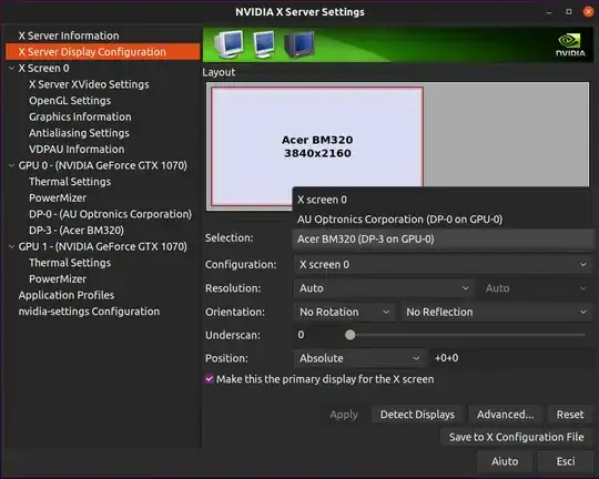

I have one laptop with external Monitor as well. Ususally it happens this, just when you selected (or it select by it self) the external Monitor as Primary and check it under X Server XVideo Settings voice . If you can see from my pic below, also me I have the external monitor as the unique selected but the build-in monitor still functional if I will switch or I will change the parameters.
Check also on the first voice Selection from X Server Display Configuration, I can see from your pic that the Down Arrow from the first voice selection it's colored , in that can show some other Monitors ; please try to open as I made in my pic. And double check on Ubuntu Settings under Monitor Section. Because Nvidia and Ubuntu system sometimes if set in different way from each other, could go in conflict with parameters....
