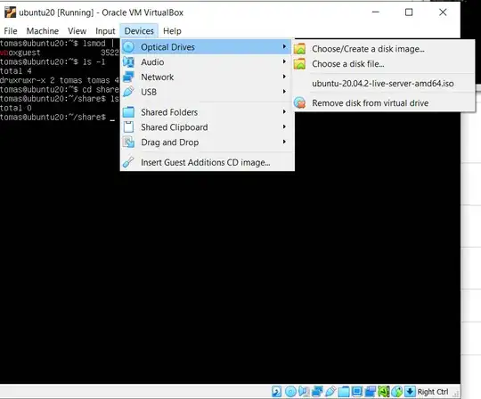

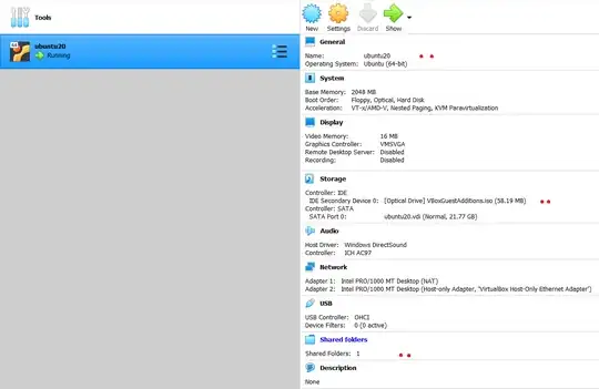

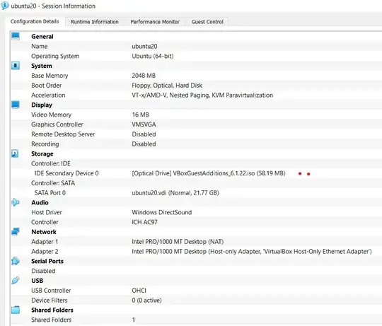

Guest additions are installed on my VM : enter image description here enter image description here enter image description here enter image description here

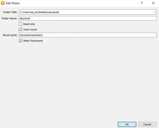

The settings for shared folder :

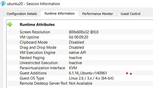

Installed the latest Guest Additions CD enter image description here

tomas@ubuntu20:~/share$ sudo mount -t vboxsf -o uid=1000,gid=1000 ubuntush /home/tomas/share
mount: /home/tomas/share: wrong fs type, bad option, bad superblock on ubuntush, missing codepage or helper program, or other error.

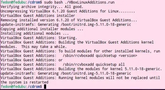

cd /cdrom sudo bash ./VBoxLinuxAdditions.run
The output of the last command should be something like that : enter image description here
However, the last 3 lines of the output I got was saying this :
"This system is currently not set up to build kernel modules.
Please install the gcc make perl packages from your distribution.
VirtualBox Guest Additions: Running kernel modules will not be replaced until
the system is restarted"
