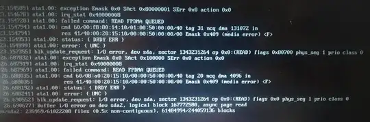

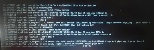

Now my PC gives a "System Problem Detected" notification every now and then. This morning when I booted up my computer it asked me to perform "fsck" as usual and this is what it showed after:
at 90.0%
After completion

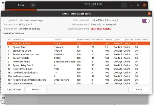

SMART Disk assessment self test:
SMART SELF-TEST
I performed a SMART DISK ASSESSMENT and i don't know why but it works randomly. Initially it shows that the assessment is at 90.0% and "Disk is ok(53 bad sectors)" and then it fails and shows that "Self-test failed(read)"(above image)

The SMART test failed, which tells you that the disk is failing.
Your file system turning read-only is a failsafe that is generally associated with a failing drive.
You cannot repair a failing hard drive. You will need to replace it.
Luckily, you are still able to read the contents of the drive so you still have a chance to back up data, in case you are behind or deficient on your back up strategy. Because a failing hard drive will only get worse, you should take advantage of that opportunity.
