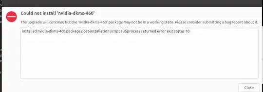

I tried to install it from the software updates I received enter image description here

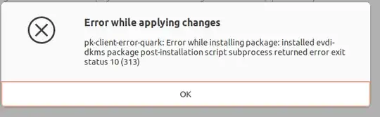

and when I am trying to upgrade I am receiving the following error enter image description here
