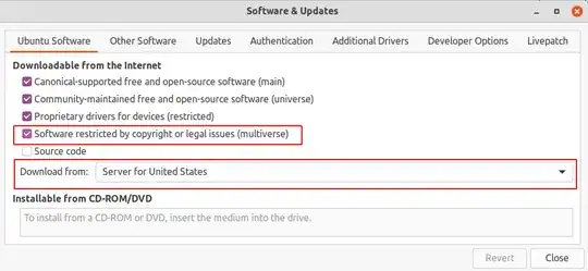

Open Software & Updates and check these settings... you may have to select a different Download from...
