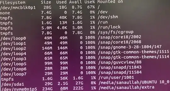

I need help to use my extra 256 GB of space in ubuntu. I am new to Linux and don't know how to use this extra space because it is not allowing me to write anything on it (means to create a folder or copy something there). For your reference, I attached the image of my current storage space, please look at the attached image.
Any help will be highly appreciated. Thanks

Are you on a Dell. If that is Gparted cli, open in GUI mode. Your 256 GB is on a separate drive. The partition named nvmeon1 is on an M2 disk. That name is reserved for m2 drives on Dell. You can check it via the dropdown menu in GUI. I am not sure if you need to mount or not, but I would assume so.
