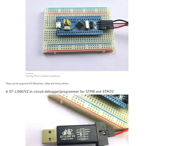

I have two Ubuntu one is 18.04 and another is 20.04, also i have some problem with Arduino boards,i have tried this instruction(pin connections and ...): enter image description here
But, the Arduino IDE can not detect the STM32f013c8t6 board with Arduino, so i tried to find the USB connection of the port by using this post commands of its answers, as you can see below:

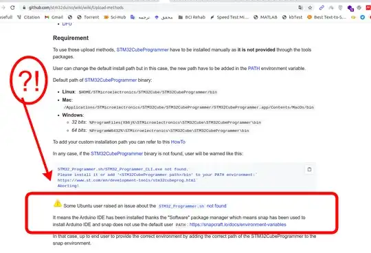

so can not see the port connection on the Arduino which has been installed by snap as you can see below :

So i guess this is not working because of installing the Arduino by snap and trued to fix it by sudo snap connect arduino:removable-media command but i get the mkdir: cannot create directory '/run/user/0': Permission denied error again, so i asked here:

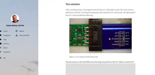

It is strange i have seen the below post which is saying the ST-link V2 programmer could be fake and have some wrong pin connection, and if possible i like to ask, what would be happening if i change the 2,4,6 pins configuration based of that post? as you can see below:
Update 3:
I have checked the ST-Link V2 and the pins was labeled correctly. so the problem is not from the wrong st-link pins system!. Thanks.

Based ofN0rbert Comment,The problem exist by snap version of Arduino which is said here:

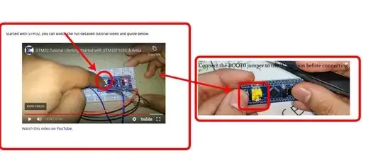

4- Switch the BOOT 0 header from the '0' position to the '1' position before connecting the FTDI board to the computer for flashing the bootloader as said on this video from this post:
enter image description hereThank.
