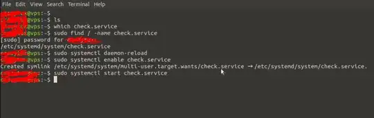

  1. Edited after comments two:
  2. To make sure your service is configured correctly follow this steps:
    • locate the service in /etc/systemd/system/LOCATE_HERE.service
    • give your script that running by the service the execute permission with sudo chmod a+x yourscript.sh
    • execute the command sudo systemctl daemon-reload to reload the new service.
    • execute the command sudo systemctl enable serviceName.service
    • execute the command sudo systemctl start serviceName.service
    • execute the command sudo systemctl status serviceName.service
    • if the service is running reboot your system.
    • after the reboot execute the command sudo systemctl status serviceName.service to check if the service is running.
    • images:
    • serviceExampleThatWorksForMe
    • howToStartTheServiceCommands
    • if all that solution is not working there might be a problem with the file type - check for solution here solutionForFileTypeError
