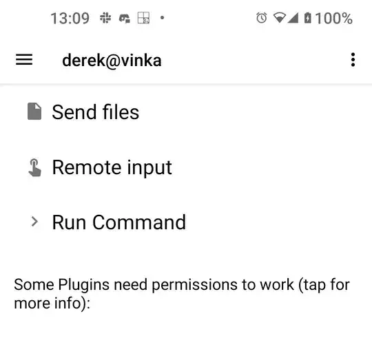

All of the plugins in the desktop app are turned on except Send notifications (which is for notifications in the opposite direction) and Inhibit screensaver.

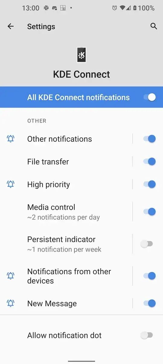

In the android app, All KDE Connect notifications is On, Persistent indicator and Allow notification dot are off:
notifications

Bruni's screenshot below is nothing like mine, but leads me to suspect I'm actually missing a plugin (There are actually no listed missing permissions).

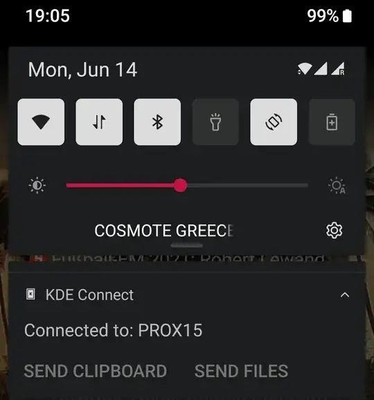

Go to the Notifications of your Android device, find kde connect and click on send clipboard.
The screenshot is from the phone. This is on KDE Connect 1.17, Android 11, KUbuntu 21.04, but I do not remember a time when it did not work on this phone and it came with android 10.

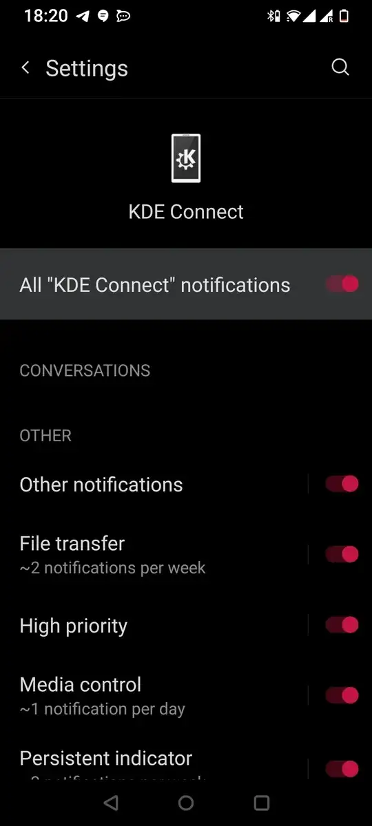

You need to allow KDE Connect to show notifications (on the phone) enter image description here
