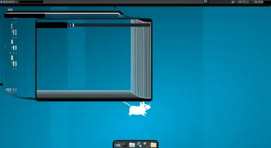

I've been using x2go XFCE4 sessions on a box for ages with no problems but after an upgrade to 21.04 (from 20.04) I'm now getting strange visual artifacts: black boxes around windows, ghosting, etc. (See screenshot below.)
If I login to the box regularly -- meaning not via x2go -- everything is fine.
Anybody have any ideas as to what might be happening?
screenshot
I had the same problem after upgrading to XUbuntu 21.04.
To fix the issue I disabled "Display compositing" by going to Settings > Window Manager Tweaks > Compositor.
I think it's related to Wayland as mentioned by @heynnema
