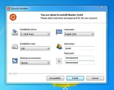

But I don't know how much disk space should I reserve for WUBI
Whatever you want: the options in Wubi are in a dropdown box so you can choose whatever you want. It really depends on what you are planning to do with Ubuntu. If it is just for testing you can go for the lowest one. If you plan to start to use it for watching video and you want to save as many as you can on the Ubuntu system you might want to go for 30. (afaik 30 Gb is the biggest size).
So should I install WUBI on D:/?
Feel free to use either C: or D:. Mind you: if you need to re-install Windows you are going to wipe C: and can re-attach D: without formatting D:. So D: is the better option. Again: this depends on what you want to use Ubuntu for: if it is temporary C: is just as a good option.
And what would Ubuntu's version be on WUBI?
Ubuntu will pick the NEWEST official release. In this case it will be the 12.04 version. See the 1st image I posted: the versio will be shown at the top.
