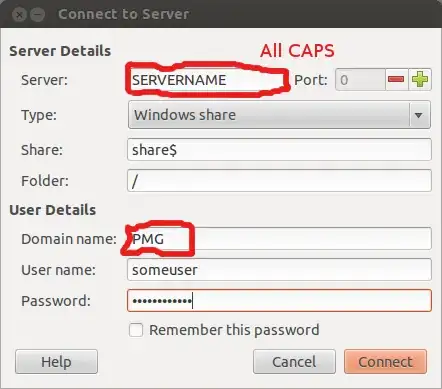

It's syntax in this case that seems to be causing the issue. I can verify that when I type the server and domain in lowercase with my credentials, it does not connect.
However...
When I type the server and domain in all CAPS with my credentials, it connects just fine.
Server Name and Domain need to be all in CAPS. Forgive my horrible outlines... :)
