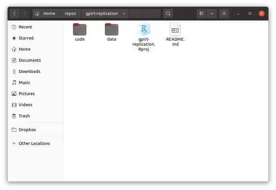

Then either re-open or refresh the file explorer, and voila!
Now you can have your precious RStudio Project and RData icons in the meantime until they're properly back in Yaru.
