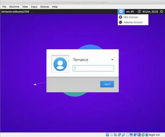

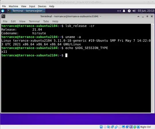

It is documented that Xubuntu (Xfce4) will be receiving Wayland in the future, but it is not there in Xubuntu 21.04 by default. I setup a quick VM and installed Xubuntu 21.04 just to verify. It defaults to x11 and Wayland is not a login option.
