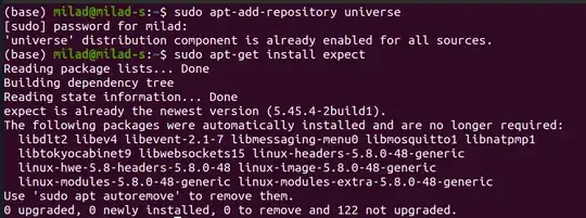

I remove expect and install it again but no difference with past!
Can anyone help me?
already newest version
This is output of dpkg -l | grep tcl; which tclsh; which tclsh8.6; dpkg -S Expect; echo $PATH. Does Anaconda contradict expect?
installed, anaconda path

You have to install the main Expect package by
sudo apt-add-repository universe
sudo apt-get install expect
and it will install tcl-expect as dependency for you.
