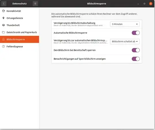

My look screen is not working or even "not presented". After reboot I can unlock the device but after that I cant lock it anymore
Super + L not working
gnome-screensaver-command -l not working, but I get
** (gnome-screensaver-command:6363): WARNING **: 10:22:19.218: unable to send message: Zeitüberschreitung wurde erreicht ** Message: 10:22:19.220: Did not receive a reply from the screensaver.
Auto lockscreen not working, although configured

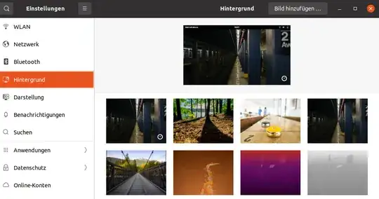

I cant even choose a lockscreen image...
Lockscreen image
Whats that?
