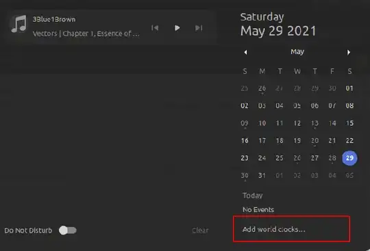

I'm on Ubuntu 20.10 and in this update, the events show at the bottom of the calendar along with the add world clock option as in the screenshot below.
I know this got here because of I installed "gnome-clocks" but I use clocks option quite often but not the world clock. So, I would like to remove the option to add world clock without removing the gnome-clocks package.

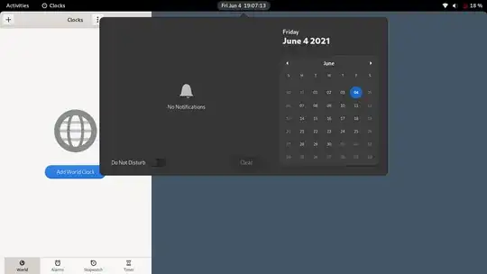

This can be achieved by creating, installing and enabling the gnome-shell extension.

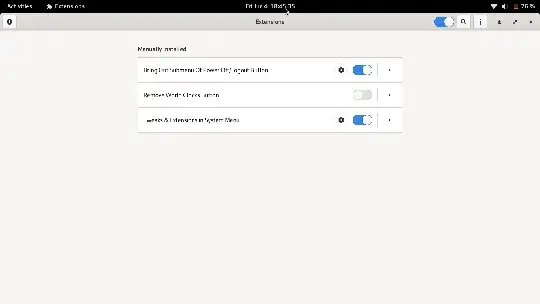

restart the gnome-shell with Alt+F2 r Enter Method. If its wayland server you need to logout and logback in.
enable the extension with below command.
5. gnome-extensions enable remove_world_clocks_button@name.mail.com
Easiest way is to install the Just Perfection extension and use this setting:
Supported in Gnome versions 3.36 up to 45enter image description here
