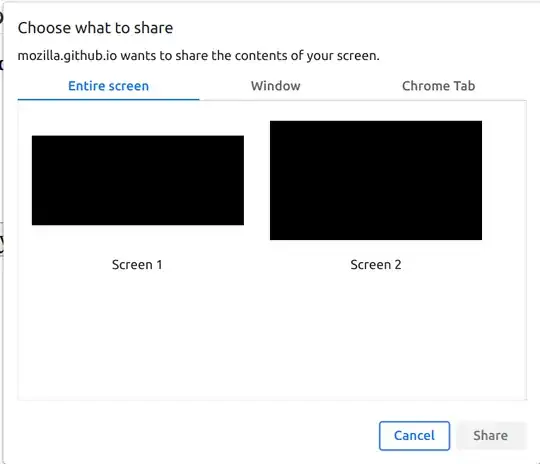

Screen share shows just a black screen after the upgrade from Ubuntu 20.10 to 21.04. It was working fine until 20.10.
Tried in Google Chrome, Firefox, etc. all of them shows just the black screen. It is not related to the browser.
Any idea how to fix this?

An alternative solution, from:
sudoedit /etc/gdm3/custom.conf
Uncomment the line
#WaylandEnable=false
and save the change. This will enable the Xorg display manager.
Then either
sudo systemctl restart gdm3
Or just reboot the system.
This reportedly works on the following versions:
  • 18.04
  • 20.04
  • 21.10
  • 22.04 LTS
  • 22.10
Note: When switching back to X11, make sure that you have the package xserver-xorg-input-all installed - otherwise your mouse and keyboard will not work.

Looks like Ubuntu 21.04 defaults to Wayland - when I switch to Xorg, screenshare works fine.
If anyone wants to try this, these are the steps:
  1. In the login screen, click the setting icon
  2. Choose "Ubuntu On Xorg" instead of "Ubuntu"
  3. Now login
Screenshare should work now.
Greenonline
  • 2,182
18
If you are using Chrome and prefer to use Wayland and do not want to switch back to Xorg, activate the following flag in the browser:
chrome://flags/#enable-webrtc-pipewire-capturer
From the flag description:
When enabled the WebRTC will use the PipeWire multimedia server for capturing the desktop content on the Wayland display server
