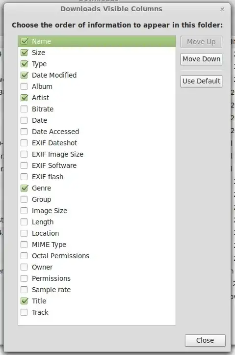

nautilus-columns from ppa:nilarimogard/webupd8 works great. You can install it with:
sudo apt-add-repository ppa:nilarimogard/webupd8
sudo apt-get update
sudo apt-get install nautilus-columns
These are the columns that are added:
nautilus-columns screen shot

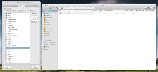

Follow this excellent how-to: Adding metadata columns in Nautilus (Ubuntu).
Here is a screenshot I took after following the how-to:
alt text
