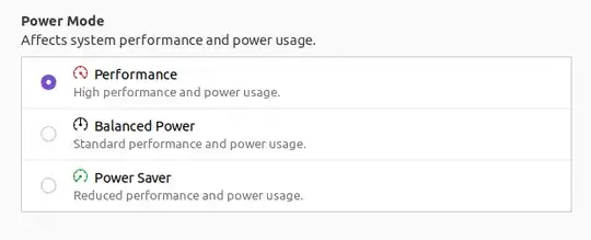

So, I use AIO device and that means this device always plugged in, and I can use performance mode but every time I reboot it auto-set to balance mode. How can I use performance mode permanently?
This what I talk about
