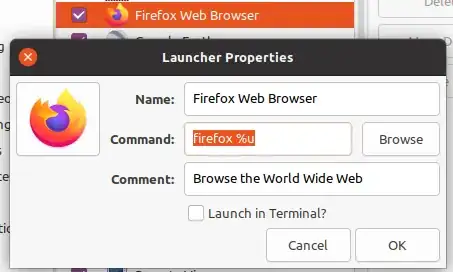

Alternatively, use the little tool alacarte (install via sudo apt install alacarte) to check where to find the executable. Find the Zoom entry and double click it to see the Command.
Application, get Command with alacarte
(I don't have Zoom installed, so that is just an example image)
