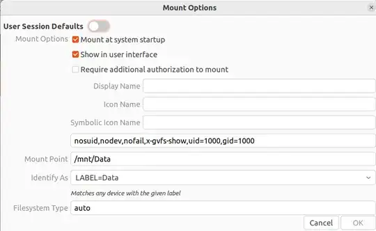

Add the following to your mounting options.
uid=1000,gid=1000

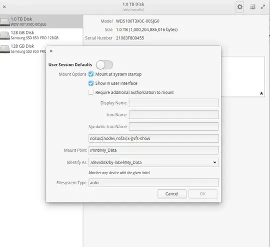

Here is the screenshot from the app. enter image description here
I fixed my permission issue on a partition-mount by clicking that icon where you pick "Edit mount options" but I chose "Take Ownership" instead.
And I have these options: nosuid,nodev,nofail,x-gvfs-show,rw,exec
