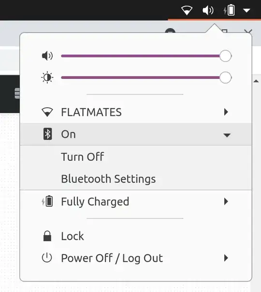

I am trying to open the Bluetooth settings in order to pair a device, but I cannot open the Bluetooth settings window even though Bluetooth is ON. Did anyone come across this and found a solution?
EDIT - I can't open other settings as well (Wi-Fi, battery)
