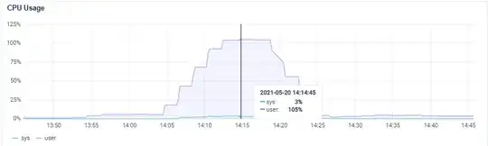

So I am fairly new to pretty much anything server related. I recently pushed my project to production. It currently has very little website visitors. I am running it on a simple Digital Ocean Ubuntu 20.04 server. Now I've noticed that sometimes all of the sudden out of nowhere the site completely goes offline (the CPU usage goes from 0% to 100& in less than 10 minutes) as seen in the image below:
see image of cpu usage chart here

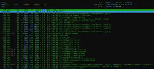

I've looked at the processes that are currently using memory and CPU.
Below is a screenshot of the htop output:
Here you can see an image of the htop output

Based on the comments stated and such, other than the UFW BLOCK issue which is explained elsewhere, it looks like your application stops responding because of some type of Denial of Service attack - some request is getting passed to Node that is causing it to eat all the CPU and freeze up. You'll need to start tracking your NodeJS logs and harden your application - it's going to be something related to your application or a NodeJS exploit that is being successfully used on your app.
