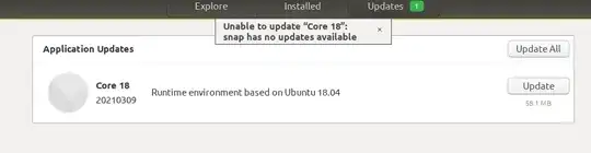

How do I solve this error on Ubuntu Hirsute Hippo (21.04)?
Unable to update "Core 18": snap has no updates available"
Screenshot of Error Updating Core 18
It's already installed as I check with the terminal:
    sudo snap install core18
snap "core18" is already installed, see 'snap help refresh'
I also try snap refresh
    sudo snap refresh
    All snaps up to date.
and I try with Ubuntu Software again and can't update it.
and I can't remove it as I use it by chromium and Libre Office
    sudo snap remove core18
error: cannot remove "core18": snap "core18" is not removable: snap is being
       used by snaps chromium, gnome-3-28-1804, gnome-3-34-1804,
       gtk-common-themes, libreoffice and 1 more.
when I try to refresh it on the terminal, no update.
sudo snap refresh core18
snap "core18" has no updates available
I belive this maybe a bug with Ubuntu Software

It seems 20.04 was hit with this as well. Maybe the bug filtered itself into 21.04 as well?
See here: https://askubuntu.com/a/1286711/1229506
I would recommend to purge Snapd completely in four steps:
  1. Save the list of installed snaps by running
    snap list
  2. Purge snapd
    sudo apt-get autopurge snapd
  3. Reinstall Snap
    sudo apt-get install snapd
  4. Reinstall snaps using list from no. 1
