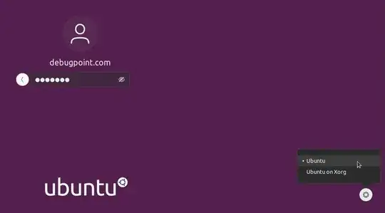

Ubuntu 21.04 uses Wayland by default, try to log out and make sure you are login using the Xorg/Xserver.
In the login page, look for an option to select which session you like to use. see this example pic login screen with drop-down having two options "Ubuntu" and "Ubuntu with Xorg"
