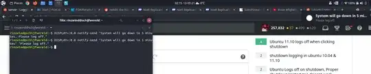

To be complete: you can also use command line to send a message to a desktop.
DISPLAY=:0.0 notify-send "System will go down in 5 minutes. Please log off."
