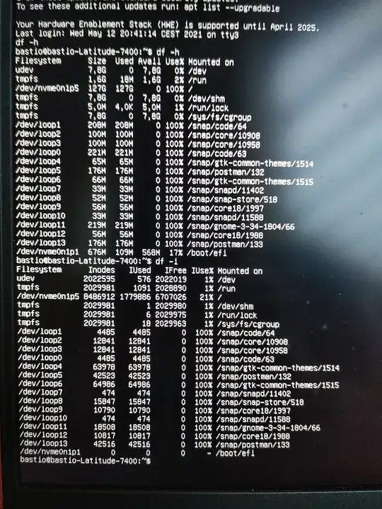

I had few disk space (but still i had some) and i decided to run bleachbit.
After restarting i can't login, i am in a loop in the login page of ubuntu. I can login with alt+f2.
Then any command I run tells me i have no space left (which i don't understand because even before running bleachbit I still had some). So i guess bleachbit did corrupt some file or disk partition ?
Here is the stat of dh -f and dh -i
I am stuck now, what can I do ?
After rebooting on recovery mode i could make some space and now I understand that my /root/cache is 77G but I don't get how/why.
