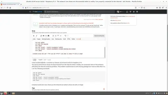

Cinnamon works but now I show you the network icon what it shows me with an image:
