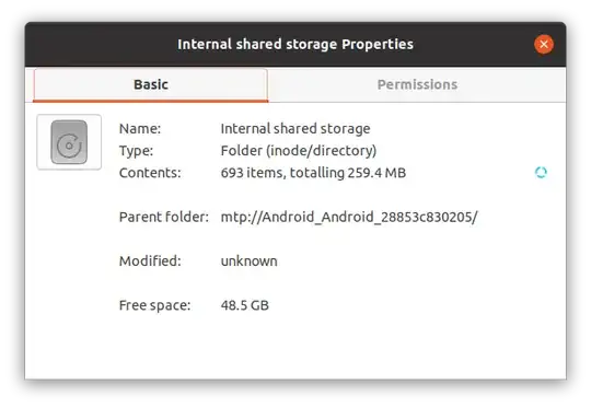

I have the same problem on my Redmi 5 Plus. I am on Ubuntu 20.04.
Unhandled error message: The name:1.177 was not provided by any .service files
I tried connecting my phone via USB on same port as usual, except it had just been used by a USB printer (EPSON ET-2756) on the same port without restarting the PC between the two connections. Tried on all other USB ports: same message.
I solved it like this:
  • Restart Redmi without connecting it to a computer.
  • Restart computer without any USB port connected especially devices such as printers or scanners.
  • Connect your Redmi via usual USB port, when prompted with Use USB to... select Transfer files.
  • Now open your Redmi phone's location on Ubuntu. No error message should appear
Proof of USB connection to Redmi phone after restart of Ubuntu 20.4
