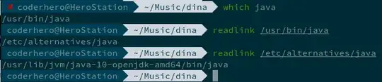

Here let's see it with java:
A one command
enter image description here Yup that's ugly!

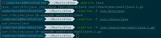

You can use that through whereis too!
You can see and can find your home directory!
