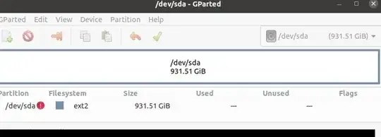

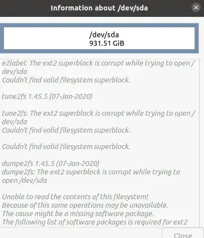

error from gparted
gparted thinks its ext2 while parted thinks its ntfs

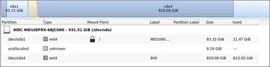

Partitionmanager when using sda system
Partitionmanager when using sda system GPT fdisk (gdisk) version 1.0.5
