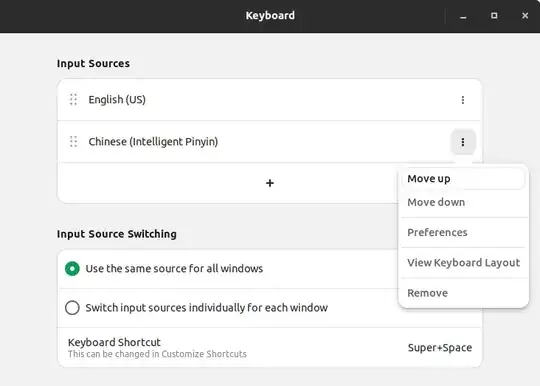

Actually, you can indeed configure intelligent pinyin to show only traditional Chinese characters. So instead of switching to another input method, you could just do the following:
  1. Go to Settings > Keyboard > Input Sources
  2. Find Chinese (Intelligent Pinyin)
  3. Click on the three-dot options button and go to Preferences

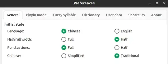

  4. In Initial State change Chinese from Simplified to Traditional
