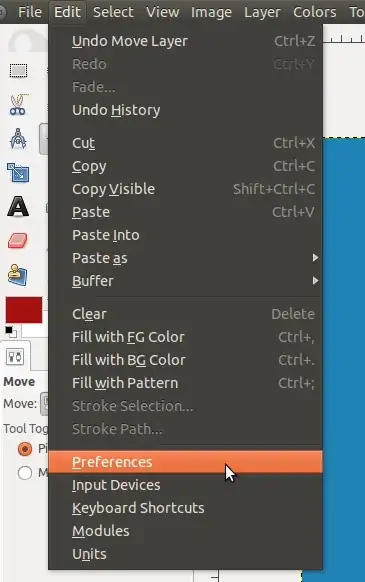

Open Gimp preferences by going to "Edit" menu.

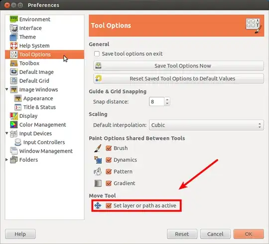

In "Preferences" dialog box click on "Tool Options" and enable the "set layer or path as active" option.
Close the "Preferences". Now Click on your desired object and it's layer will be selected automatically. Hare's an example! enter image description here

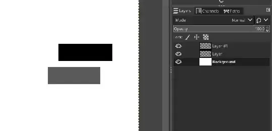

It should be possible to select a desired layer with Alt + Middle Mouse Button. A preview from GIMP v2.10.30 on Linux KDE Neon OS:
