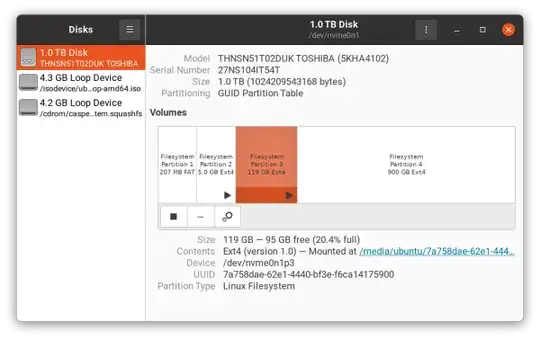

  1. Boot into a Ubuntu Live ISO, and click Try Ubuntu
  2. Open the "Disks" app
  3. In the left panel, click on your system disk
  4. In the main panel, select your root partition
  5. Click the symbol towards the bottom left to mount the parition
  6. You will see a "Mounted at" link appear next to the the "Contents" label
  7. Click on this link to open the location in Nautilus
  8. From the Nautilus location bar, click the down arrow, and select "Open in Terminal"
  9. In the terminal type the following
    sudo nano ./lib/udev/rules.d/61-gdm.rules
    (Make sure the path starts with ./ because you want to edit the 61-gdm.rules file relative to the current mounted location).
  10. Comment out all of the lines, as shown:
    # disable Wayland on Hi1710 chipsets
    # ATTR{vendor}=="0x19e5", ATTR{device}=="0x1711", RUN+="/usr/libexec/gdm-disable-wayland"
    # disable Wayland when using the proprietary nvidia driver
    # DRIVER=="nvidia", RUN+="/usr/libexec/gdm-disable-wayland"
    # disable Wayland if modesetting is disabled
    # IMPORT{cmdline}="nomodeset", RUN+="/usr/libexec/gdm-disable-wayland"
  11. Type CtrlX, then Y, and then Enter to save your changes and exit Nano
  12. Remove you Live ISO and reboot
