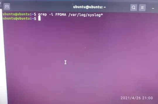

Edit: I am not sure how to do the grep -i FPDMA /var/log/syslog* and couldn't find any info on the web so I simply paste the command in a terminal but nothing happend: enter image description here
As for the Disks SMART Data & Tests, the menu is grayed out:
