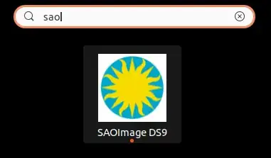

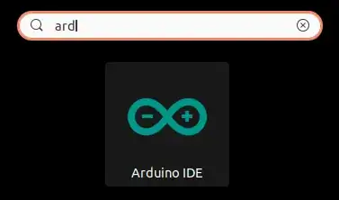

Here, the icon file is in the same folder as the program. Now, when I press the super key and start typing "ard..." I see the Arduino icon, and it starts Arduino:
Likewise, when I press the super key and start typing "sao..." I see the SAOimage icon, and it starts SAOimage.

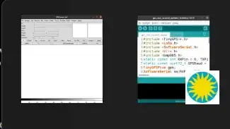

But once the programs are running, when I ALT+TAB between applications, Arduino is represented by the SAOimage icon, and SAOimage has no icon!
Also, if I first start SAOimage and then Arduino, they start in that order. But if I start Arduino first, and then press super key, type sao and start SAOimage, the program doesn't start; instead focus is just shifted to Arduino.

I bet it has to do with the StartupWMClass, the last line of both desktop files; specifically, the confusion stems from how their values are identical.
From this post we can see that StartupWMClass is used to describe what application is responsible for a window (in case an application is creating several different kind of windows).
Now if you have two separate applications in your scenario, you possibly don't even need the StartupWMClass declaration; or at least, definitely not with identical values in both desktop files.
