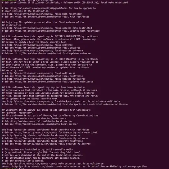

Output from /etc/apt/sources.list :- enter image description here
You are currently using Ubuntu 20.04 focal. You have to comment out the problematic line in /etc/apt/sources.list with cosmic release and then retry with:
sudo apt-get update
