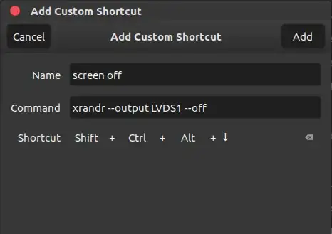

Here's how I have solved this problem. I use a keyboard shortcut to turn the laptop screen on and off.
First, run the following command to list your displays:
xrandr
Your laptop screen name should be something like LVDS1. You will need this name later.
Next, set a keyboard shortcut through Settings > Keyboard and click on the plus symbol near the lower right side of the window.
For the name, enter "screen off"
For the command, enter the following command but replace LVDS1 with the name of your laptop screen which may or may not be the same:
xrandr --output LVDS1 --off
Now, click on "Set Shortcut" and press CRTL+ALT+SHIFT+ (the last one is a down arrow if it's hard to see).
Finally, click "Add" to save the shortcut.
image settings window to add a keyboard shortcut with the options filled in as described in the instructions
