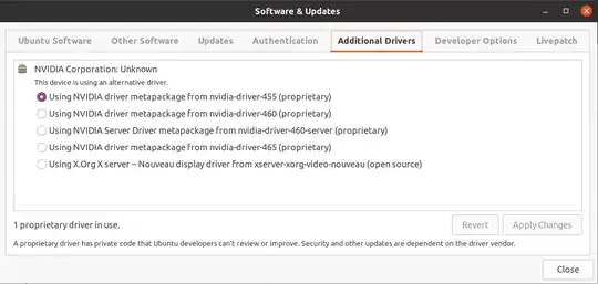

I was trying to install the driver for my NVIDIA 3080 GPU using the Software & Updates app. But I couldn't find the tested option in this app like (tested, proprietary). And it also shows This device is using an alternative driver.
I was wondering how I could install the tested driver through this app.
Ubuntu version: 20.04.2 LTS
Outputs of apt-cache policy nvidia-driver-465
nvidia-driver-465:
  Installed: (none)
  Candidate: 465.19.01-0ubuntu1
  Version table:
     465.19.01-0ubuntu1 600
        600 https://developer.download.nvidia.com/compute/cuda/repos/ubuntu2004/x86_64  Packages

To answer why none of the drivers in the Software and Updates section are marked as tested, it is possible that because your RTX 3080 is a newer card (and because of the stock shortages) the driver has not yet been tested by the ubuntu devs.
It also might be caused by ubuntu not recognizing your GPU for one reason or another (based on it being marked as NVIDIA corporation: unknown at the top of your screenshot)
Some more info on the "tested" tag on a driver: What does "tested driver" mean?
