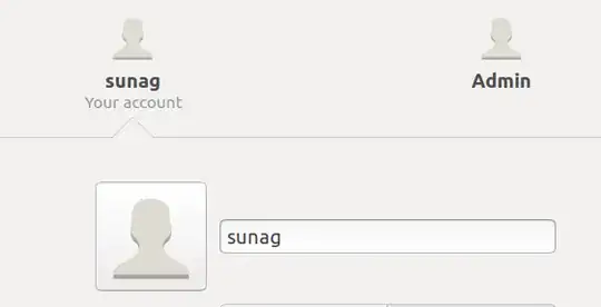

I need to change the username from the linux (Not admin).
I changed in settings ->Users. But how to change the "home folder" name or root user in linux.

Any leads will be appreciated. I have attached a screenshot of changed username in Settings > Users.
