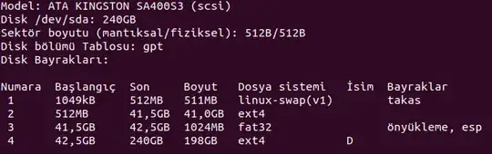

When installation has enden I didn't see my "other" partition on file browser. Somehow it seen when I open Disks app or Gparted app. I thought that it has happened because I partitioned as fat32. So I have deleted that partition by using Gparted and I create a new partition with same size as ext4. After sudo parted -l, I get:
So the problem part is number 4
How can I see and write on my 198 GB partition? TIA

You will need to tell the OS where to mount that partition; check /etc/fstab to see if there is an entry for it. If there isn't then create a mount point for it on the root filesystem, check that you can mount it with the mount command and when it works and add an entry in /etc/fstab to mount it automatically at boot. The man pages for the mount command and the format of /etc/fstab will help you. See also the Ubuntu help wiki page on fstab.
GParted always runs as root therefore the partition you created is owned by root.
You can either chown user:user mountpoint -R (please note that "user" and "mountpoint" are placeholders and "-R" means recursive) or, considering that you have nothing there, simply use Disks instead of Gparted. Disks runs as your own user therefore the partitions it creates are owned by you. Simply select, remove and create another with the right-click menu.
