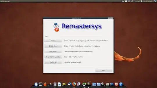

Here is the screenshot
Source: http://www.remastersys.com/ubuntu.html
