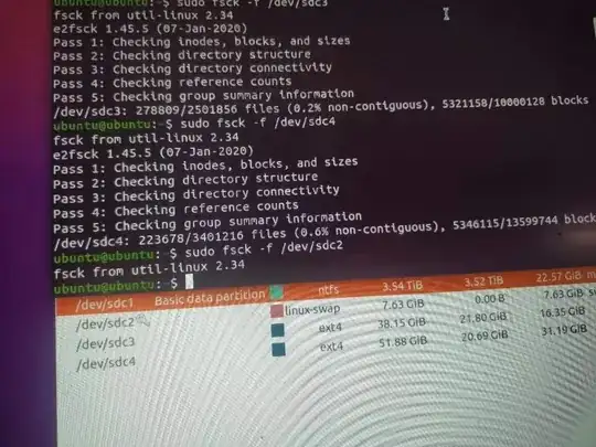

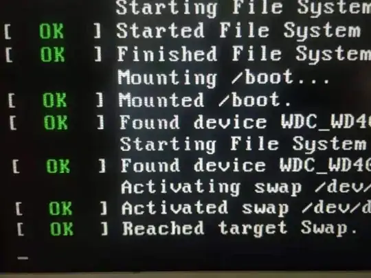

and stuck on here: enter image description here
Again I used these instructions from Error on Ubuntu boot up - "recovering journal"
If for some reason you can't do the above...
boot to a Ubuntu Live DVD/USB
start gparted and determine which /dev/sdaX is your Ubuntu EXT4 partition
quit gparted
open a terminal window
type sudo fsck -f /dev/sdaX # replacing X with the number you found earlier
repeat the fsck command if there were errors
type reboot
enter image description here But nothing changed after that.
