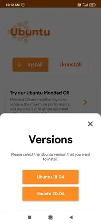

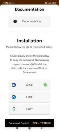

Simplest method - If you don't want to get your hands dirty, install Termux, and simply download either Andronix (Website, GitHub) or AnLinux, and install Ubuntu 20.04 with them. These apps provide the scripts to download and extract the base image, to install desktop environments (e.g. XFCE), and setup the VNC server, which you simply need to copy-paste in Termux.
enter image description here enter image description here enter image description here
User interface of Andronix
How to use it?
When done, enter the command ./start-ubuntu20.sh to open Ubuntu, and the command exit to leave Ubuntu. Once you start Ubuntu, enter the command vncserver-start to start the VNC server (with the XFCE desktop), and the command vncserver-stop to stop it. (unfortunately, it is named ubuntu20, although it is actually Ubuntu 20.04, not Ubuntu Core 20. Once you get an idea how the script works, you can rename everything to ubuntu20.04, or anything else)

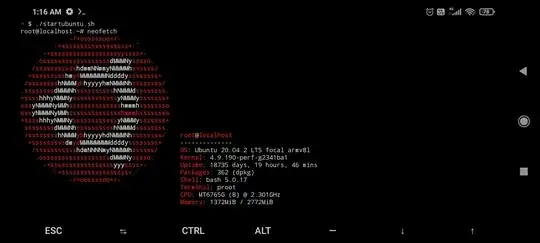

enter image description here Some of the entries (e.g. uptime) are wrong due to fake /proc entries, otherwise recent versions of Android would not let Ubuntu work.

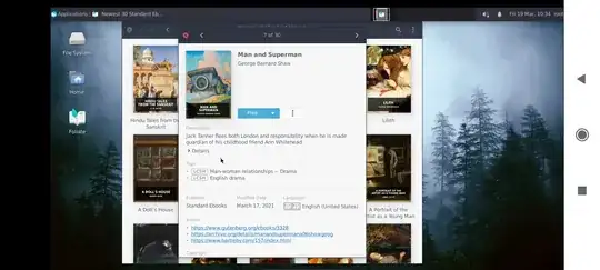

xfce foliate Applications running in XFCE desktop. I installed Tango icon theme and Arc GTK theme

This script downloads the Ubuntu rootfs image for the architecture of your device, and then sets it up to work with proot. Recent versions of Android (v10, v11) impose some restrictions, and that is why this script creates fake entries in /proc to fool Ubuntu and Android into functioning normally.
